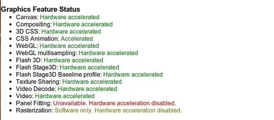

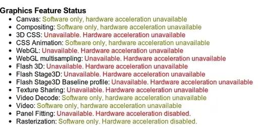

chrome://gpu/

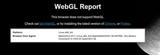

And http://webglreport.com/
 google-chrome --version
 Google Chrome 27.0.1453.93
http://www.chromeexperiments.com/webgl

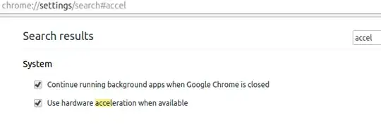

Step 5: Go to chrome://settings and enable Use hardware acceleration when available. By default it is off since version 43.

If you still don't get any results, check if hardware-acceleration is enabled in Chromium settings, Google tends to disable this setting by default since version 43. In this case that was the problem for me after I updated GPU drivers, overrode the GPU blacklist, and so and so.

  5. Check that Use hardware acceleration when available is ENABLED in chrome://settings/system
