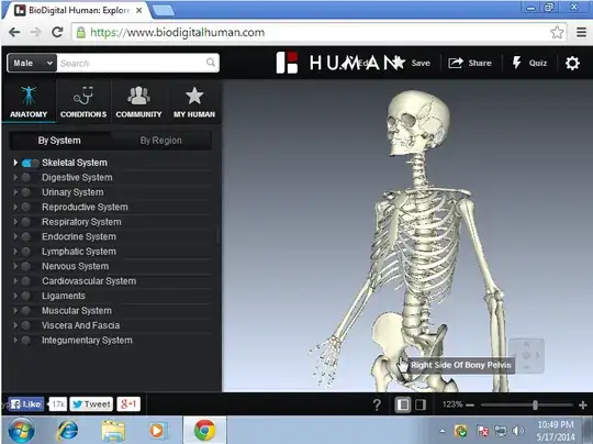

i am unable to visualise many 3d graphics of different applications [ex:-biodigital human 3d of chrome store] and many more 3d games and graphics i am current using Gallium 0.4 on AMD RS780 as my graphic card and do not know whether it is functioning or not in ubuntu but in windows 7 it works so can any body suggest stepwise settings or sequence of commands to get it fixedenter image description here

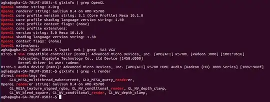

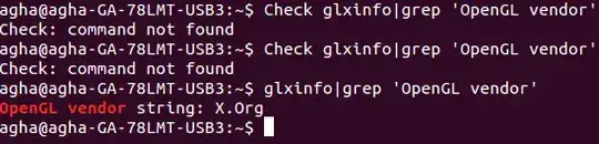

and this is shown when i type the command in terminal to know about my graphics card enter image description here enter image description here
*edit enter image description here
