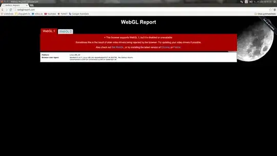

WebGL report: enter image description here
Full resolution: https://i.sstatic.net/RWvA1.png

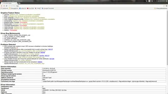

chrome://gpu: enter image description here
Full resolution: https://i.sstatic.net/Z0P8E.png

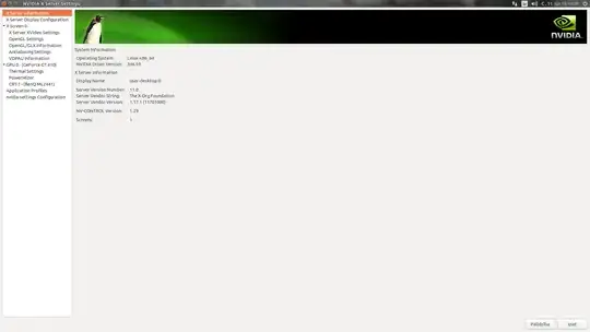

Nvidia Information: enter image description here
Full resolution: https://i.sstatic.net/AYkDJ.png

I believe this is duplicate of WebGL doesn't work in Chromium on Ubuntu question as @Tim noted, here is my answer on it:
The ubuntu maintainer of Chromium has deliberately disabled GPU acceleration in the ubuntu build in Chromium 43. Here is corresponding bugreport: https://bugs.launchpad.net/ubuntu/+source/chromium-browser/+bug/1463598
To workaround this issue you can downgrade to a previous version of Chromium (I have installed 41.0.2272.76-0 from Vivid).
