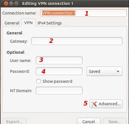

Check your settings with it.
VPN connection in Ubuntu
Go to network manager > VPN Connection > Configure VPN > Add VPN
  1. Name VPN Connection ( Any Name )
  2. Gateway : You ip address of pptp server Or FDDN ( Fully Qualified Domain Name )
  3. User Name
  4. Password
  5. Click on Advanced
Click on " Use point to point encryption " Click OK & Save
Now open terminal
 tail -f /var/log/syslog
And just connect to VPN & check your logs.
