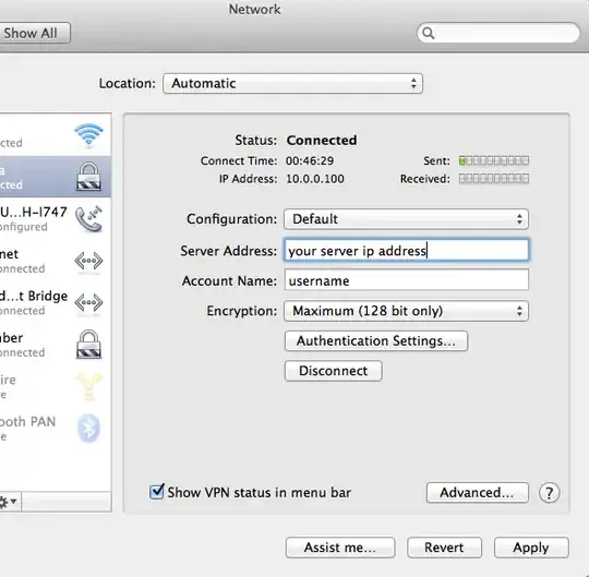

For Mac, make sure you added PPTP VPN connection. Besides that you only need to setup server address, account name, and password in authentication settings. No pain here.

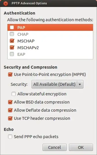

For Linux, NetworkManager to add VPN connections. Make sure you added PPTP VPN connection. And the configuration I use is here:

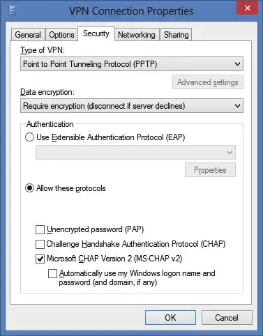

And for Windows

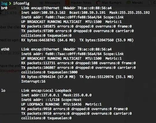

Run ifconfigand find your default interface, in my case it was br0 (I changed it to allow virtual machines on my physical machine to share the interface. Yours will probably be en0)

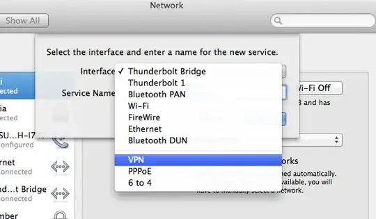

Add VPN on client computer (Mac)
System Preferences > Network > [+] > VPN

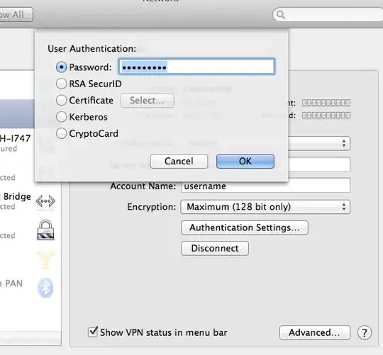

Then choose Authentication settings > Password, then fill in your password here
