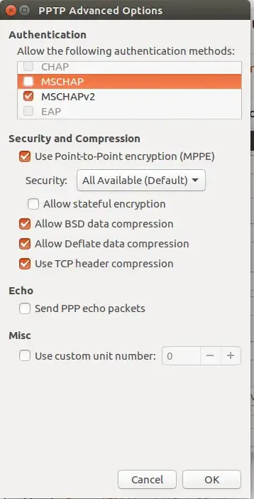

I fill up the details as in this answer. But when I try to connect, I get:

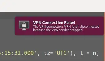

VPN Connection Failed '...because the VPN service stopped'
error message on the top right corner of the screen: enter image description here
running
tail -f /var/log/syslog
gives me this:
