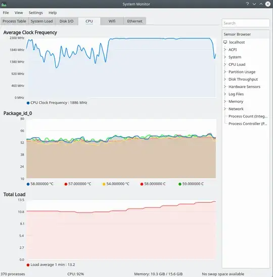

You mentioned KSysGuard. Note that you can make your own tab with e.g. average clock frequency, CPU temperature, and total load:
System Monitor tab

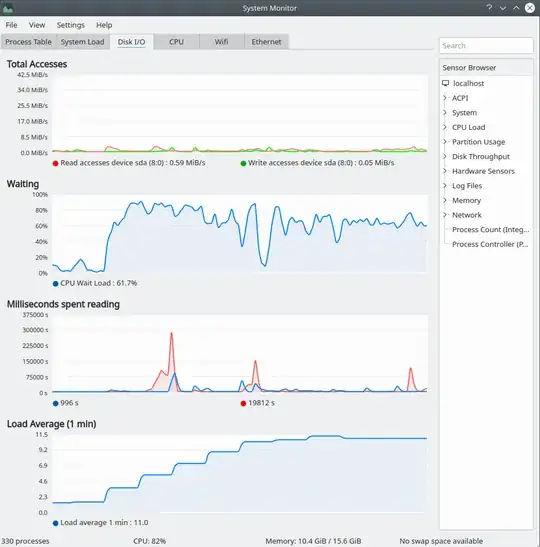

You can also examine Disk I/O, such as read and write, iowait, and read/write time:
Disk I/O tab

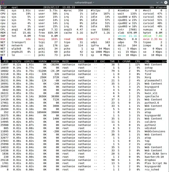

The atop program is often helpful for diagnosing system performance issues. Here it is showing disk activity in red under high load:
atop DSK sda busy

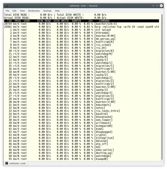

Finally, if you find that disk activity is the cause of the issue, you can monitor and change the priority of individual processes with iotop (note that it requires root/sudo).
iotop screenshot
