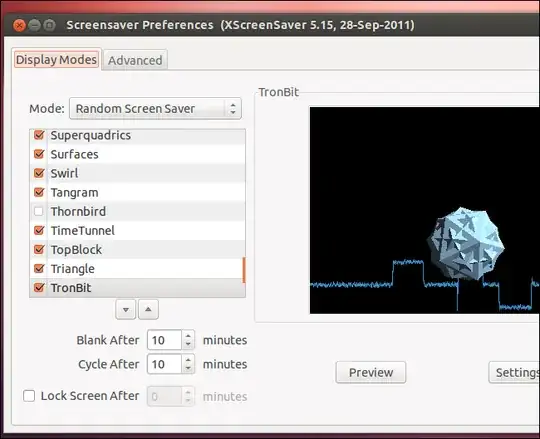

Configuring your screensaver
After installation, perform a search in the Dash for Screensaver. Launch the Screensaver utility and use it to configure XScreenSaver and select your screensaver settings.
The Screensaver utility will prompt you to stop the gnome-screensaver process and launch the xscreensaver background process when you start it.
By default, XScreenSaver will choose a random screensaver each time it starts. You can specify the screensavers it chooses from or enable "Only One Screensaver" mode to always use your favorite screensaver.

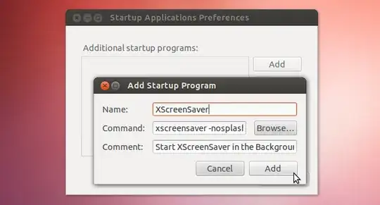

Adding to Startup
To actually use the screensavers, you'll want XScreenSaver to start in the background each time you log in. If it doesn’t start, it can’t notice your system is idle and launch screensavers.
Get started by launching the Startup Applications utility from the Dash. Add a startup program with the following command. The name and comment here can be anything you like:
xscreensaver -nosplash
