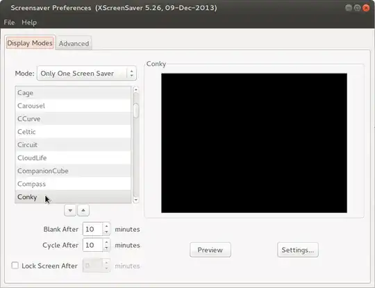

7) Select "Conky" as screensaver
Screenshot
You can find more information on how to set xscreensaver as default screensaver in Configure screensaver in Ubuntu.
