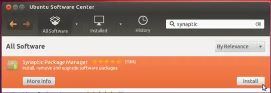

The Ubuntu Software Center’s simplified interface doesn’t offer the option to downgrade packages. Synaptic, a more advanced graphical package manager interface that Ubuntu used to include, offers this option. To downgrade a package graphically, first install the Synaptic application:

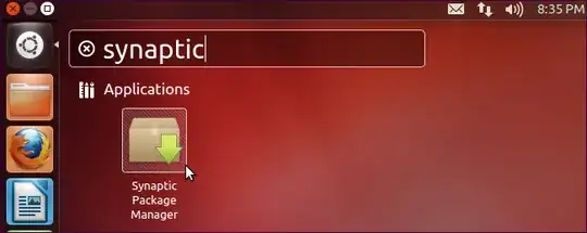

After you done this, open the Synaptic Package Manager from the Dash:
synaptis

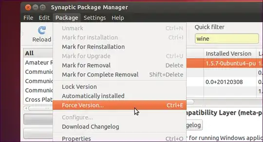

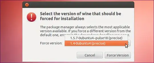

Search for the package you want to install an older version of in Synaptic, select it, and use the Package > Force Version option:
Force version
Select the version you want to install and click Force Version. Synaptic will only show you versions available in your repositories:
Select version

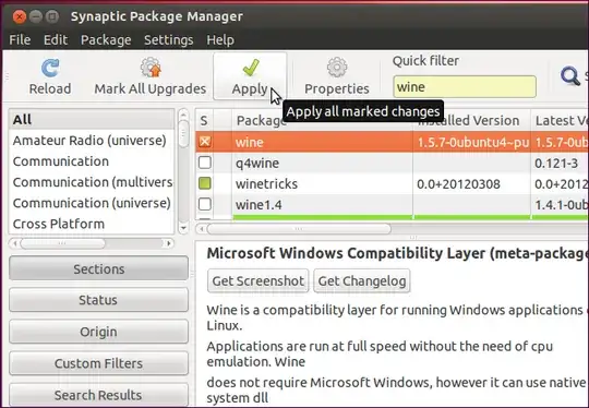

Click the Apply button to apply your changes and install the older version of the package, assuming everything works properly.
Apply

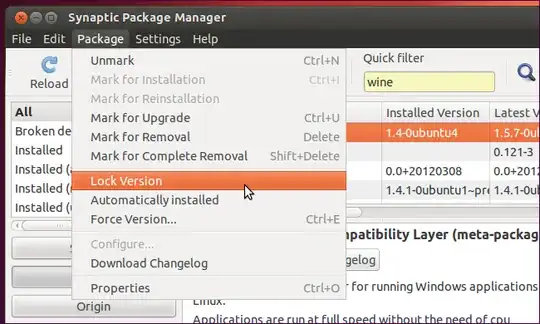

After you downgrade the package, select it and use the Package > Lock Version option. If you don’t do this, Ubuntu will try to upgrade the installed package the next time you update your installed packages:
Lock version

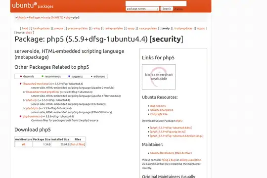

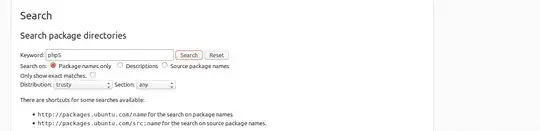

Lets find the archived package on http://packages.ubuntu.com/:
For example downgrading php5 :
Search:

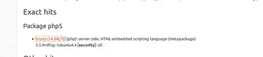

Found an exact hit lets look at the package page for php5 :
We can see the different versions of Ubuntu releases here we are at trusty:

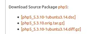

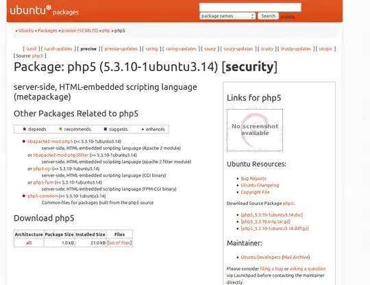

Lets switch to version that ran php (5.3) ... 12.04 (precise) for example:
download the tar.gz
