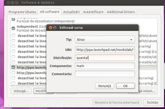

You should choose Modify in Software & Updates > Other software from raring to quantal distribution.
