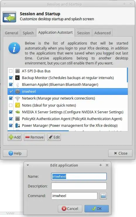

Xubuntu:
Use the "Session and Startup" GUI editor --> Application Autostart --> Add to add imwheel as a startup program.
More screenshots here: https://askubuntu.com/a/369443/327339.

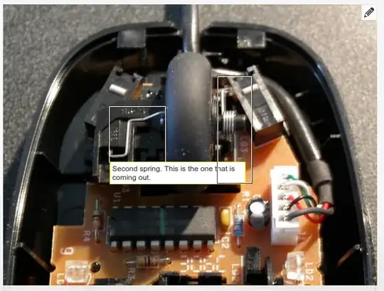

While the above imwheel suggestions helped a bit, I found that removing the mechanical scroll-clicking mechanism made my mouse wheel much more pleasant to use -- not only removing the click, but making it faster and more precise to control!
And it only took 3 minutes - check out these instructions:
http://www.instructables.com/id/Making-a-mouse-wheel-not-click./
In a nutshell, you're removing this left spring (be careful to get the right spring back in place exactly):
Note: I have a standard, cheap mouse - a Logitech B100, others report success on similar models. Your mileage may vary.
