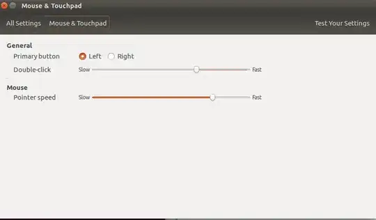

In Mouse settings, I get only
where I cannot change to scroll many lines. So I want to move many lines only in Google Chrome. I cannot find the feature in Settings > Search Mouse and Select the view.

For instructions on changing your scroll speed system-wide, please see the Increase mouse wheel scroll speed discussion on AskUbuntu.
If you don't want to bother with installing and configuring the imwheel package, you can just change the scrolling speed in your web browser; this will only affect your web browser and no other applications on your computer.
In Firefox you can change the scroll speed in the about:config options (google "firefox scroll speed" for details).
If you use Chrome or Chromium as your browser, there is no longer a direct option to adjust scroll speed. However, you can adjust it by installing one of the following extensions:
https://chrome.google.com/webstore/detail/smoothscroll/nbokbjkabcmbfdlbddjidfmibcpneigj?hl=en
https://chrome.google.com/webstore/detail/chromium-wheel-smooth-scr/khpcanbeojalbkpgpmjpdkjnkfcgfkhb?hl=en
and then adjusting the "step size" in the extension's preferences.
