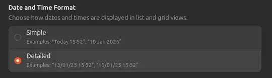

Ubuntu 24.04 Nautilus 46.2 and maybe earlier
Preferences>Date & Time Format:
Simple (10 Jan 2025) or Detailed (13/01/25 15:52) enter image description here For more options, see other answer ATutorMe.
