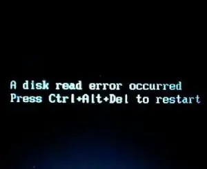

Now when i boot the PC and try to load into Windows i get the following error
I googled and found that its the boot loader error on the grub2. But i am not sure how i can fix the error after trying out a few ways as described in these forums hence am posting a question here.
