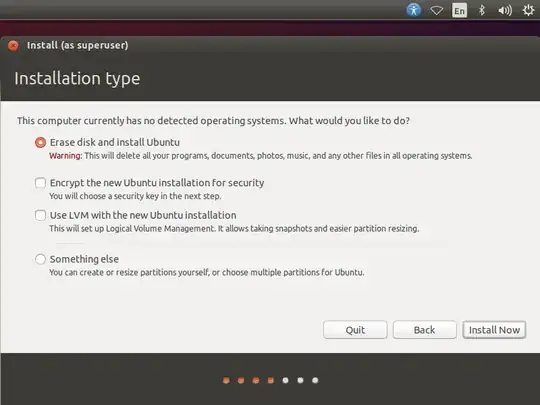

I used the bootable USB to install Ubuntu. When given the options similar to the screenshot, I selected "something else". the following screen showed me how my drive was currently partitioned. I selected each partitions location and finished installing Ubuntu. Ubuntu installed itself over the root '/' partition.
Installation was successful.
screenshot of installation step with several methods for installing ubuntu
