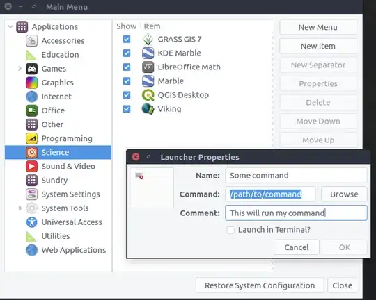

Instead of manually adding .desktop files, you can use the little GUI tool alacarte (Main Menu) to do this for you.
Installation:
sudo apt install alacarte
alacarte Screenshot
