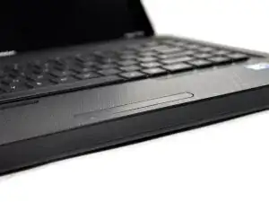

HP G42 touchpad
Given its touchpad position and configuration you trigger the secondary and terciary click while typing as they are bound to the Left Top and Left Bottom corner*.
I know how to fix this(** , ***), I have this:

In my /usr/share/X11/xorg.conf.d/50-synaptics.conf file. And it should work as setting those options with synclient but ubuntu decides for some reason that I knows better and I can't override the setting.
Why? and, most importantly, how can I fix this?
