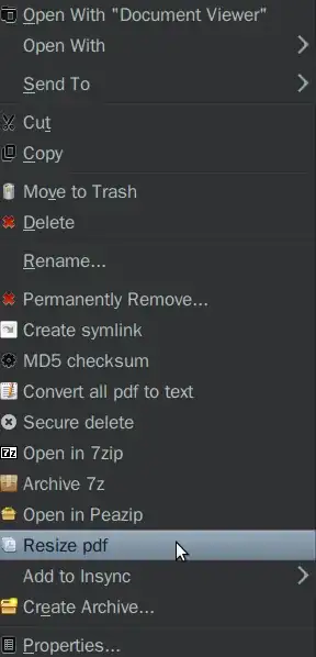

I have added the script into a text file, made it executable, and added the path to it into Thunar custom actions with the name 'resize pdf'.
But, when right-clicking the selected pdf and running 'resize pdf', I get this error:
