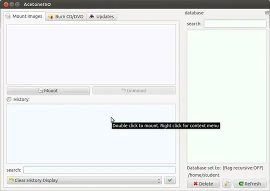

Install acetoneiso by sudo apt-get install acetoneiso command.
The open it by typing acetoneiso in the dash, and click on the icon.

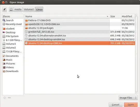

The click on the "Mount" button. And select the iso file to mount.

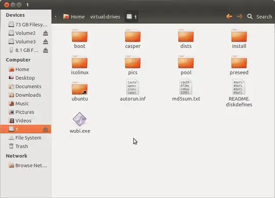

The open Nautilus (File browser) to see the iso mounted on a folder named 1.
Then you should be able to install program from the iso file.
