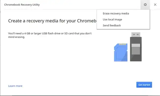

You can install any iso file on a USB using Chromebook/ChromeOS.
There's an app called Chromebook Recovery Utility, which it's main purpose is to create a recovery of your chromebook on a USB.
But, it has the Use local image option that can install any iso file on a USB drive. See screencap below.
* In order for the iso to appear in the listed of available images, you'll need to rename the iso file to have the extension .bin.
I had issues simply changing *.iso to *.bin--the Recovery Utility seemed to work, but the resulting USB wasn't always bootable.
Fortunately there is an easy fix:
  1. Right-click on the *.iso image you want to write
  2. Choose the "Zip selection" option from the menu
    this will just create a *.zip file of the *.iso image and should only take a couple minutes. Once that's done...
  3. Open Recovery Utility
  4. Select "Use local image" from the settings menu, represented by a gear symbol
  5. Navigate to the folder where the iso and zip file are located ("Downloads"??)
    You should see the *.zip file you just created listed in the resulting menu of files Recovery Utility can use.
  6. Select the zip file, and let Recovery Utility work its magic.
    Once it's done writing to the USB drive...
  7. Eject the USB and use it like any other bootable USB.
I was able to create a bootable Xubuntu USB drive, among others.
