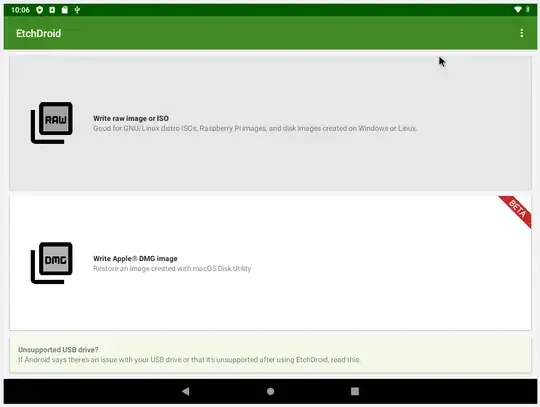

Started EtchDroid and selected "Write raw Image or ISO.

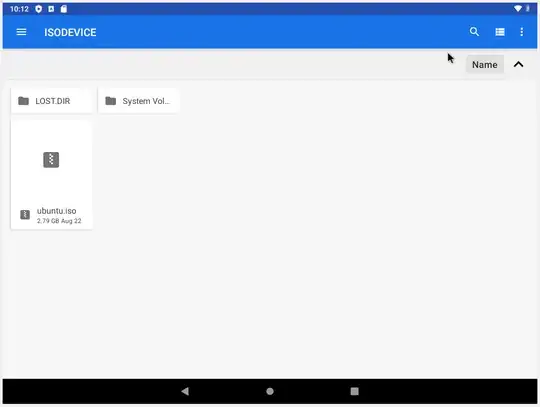

- Selected the Ubuntu ISO file

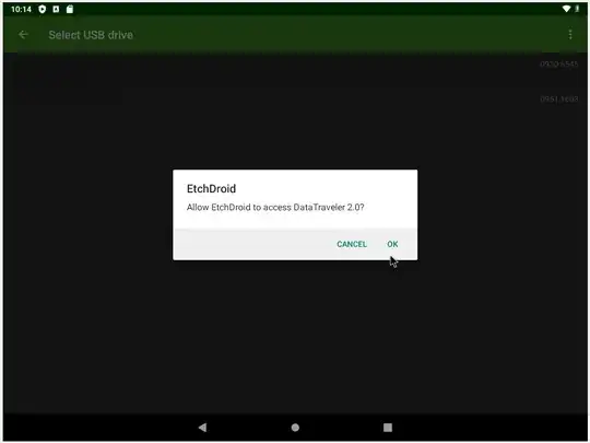

- Selected the target USB from upper right on the screen: .

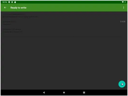

And clicked the write icon on the lower right.
There is no progress meter, at first I thought nothing had happened but when I returned later I found that the USB was ready for a Live boot or Install.
