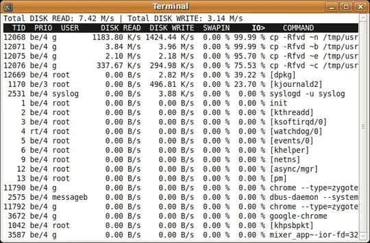

You can use iotop. To install, open a terminal and execute the following command:
sudo apt-get install iotop
To use iotop, open a terminal and type the following command:
sudo iotop
iotop features real-time display of all disk activity and also displays the command responsible for the activity and the user behind the command just like Resource Monitor.
Click here for more information.

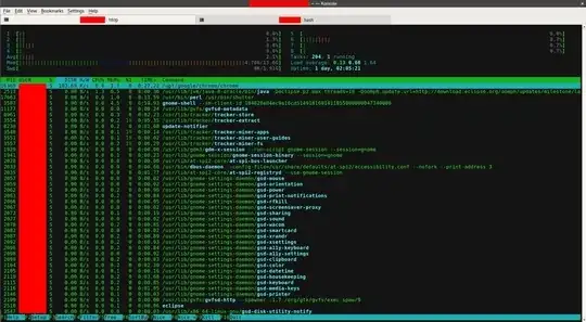

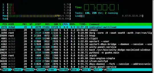

Also similar to resource monitor is htop in it's ability to identify and kill processes:
sudo apt-get install htop
and to run htop in monitor mode:
htop
or, for more features and permissions to fully debug and kill individual processes etc.:
sudo htop

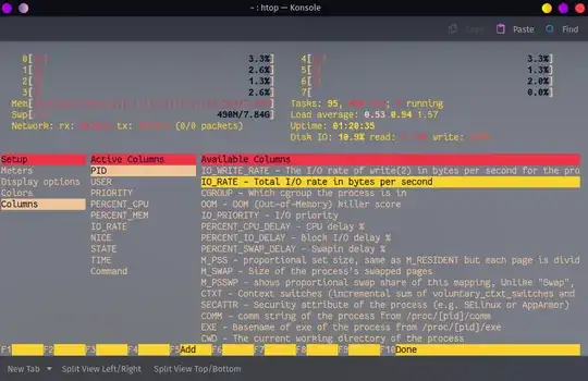

You can use htop.
sudo apt install htop
Then open htop and configure it: F2 -> Columns -> Set IO_RATE (or IO_RATE_READ/IO_RATE_WRITE) -> F10
And you will see something like this:
screenshot

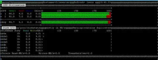

You can try nmon
sudo apt-get install nmon
Try:
nmon
Output Like below:
Press d = Disk | Press c = CPU Info |Press r = RAM info | Press q = to exit

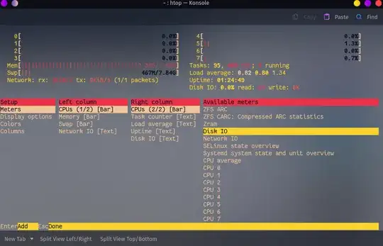

Install htop first sudo apt install htop
As answered above by RedEyed if you want to see read write in bytes/sec for individual processes go to setup (F2) --> Columns --> Available Columns --> Select IO_RATE (as shown in the image below)
But if you want an overall disk IO read write to be shown like this :
Go to setup (F2)--> Meters --> Available Meters -->Disk IO and enter add and select where do you want it to be Left/Right Column and you're done.
