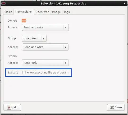

Right click on the file, click on properties, then go to the Permissions tab, and check the box that says "Allow executing this file as a program".

If running a .jar file from the command line works (java -jar myFile.jar), but double-clicking it in the GUI does not, and if sudo chmod +x myFile.jar appears to succeed but you still can't open with double-click, and if right-clicking the .jar file > Properties > Permissions > "Allow executing file as program" does not work (i.e., the checkbox switches back just after you click it), then probably the .jar file is on an NTFS file system, which does not allow execute permissions on a per-file basis. (You may have this problem if you dual-boot, for example, and have a shared NTFS partition between Ubuntu and Windows).
