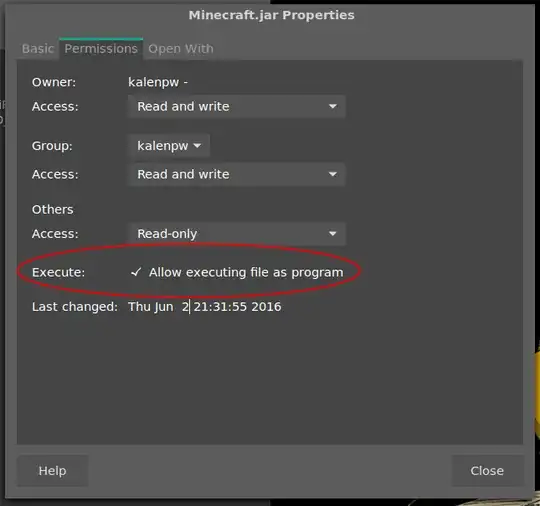

Although the terminal version already posted is easier for completeness sake, you can also right click the .jar in a file explorer go to Permissions and select allow executing file as program.
Image of checkbox
