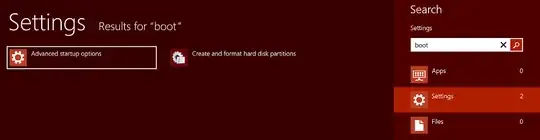

  • Press search button on your keyboard type 'boot'.
  • Select 'settings >> Create and format disk partitions'

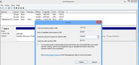

  • Select C drive, right click and select 'shrink volume'.
  • This is your choice but I use appox. 29.3 Gigs(30,000 MB): Shrink respectively.

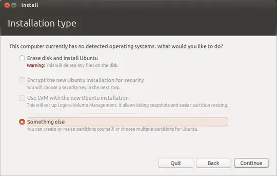

  • Change the selection from 'Delete and Install' to 'Something Else' at the bottom.
  • It will ask if you want to unmount your installation device. Select 'No'.

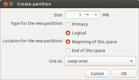

  • Now select the free space and press the '+' button under the partitions.
  • Select from the drop list 'swap' and select the 'logical' radio button and 'insert at beginning' and finish. Select anywhere from 400 to 600 MB to be safe at least.

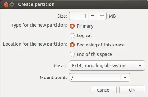

  • Now select the free space and press the 'change' button - again.
  • Select from the drop list 'Ext4' and select the 'primary' radio button, 'insert at beginning', 'format' button checked and '/' as root and finish. Use the remaining space you have reserved.
  • Finish install process on the Ext4 partition you created.
