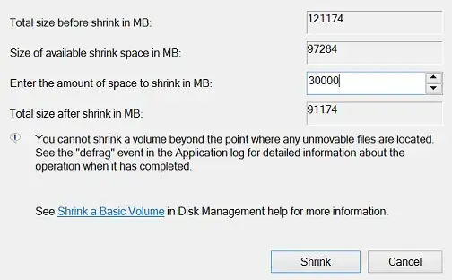

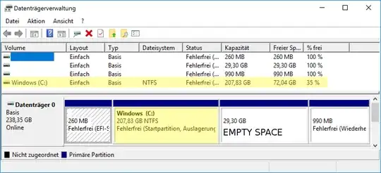

Shrink Windows partition
  1. Press search button on your keyboard type partitions
  2. Select Settings >> Create and format disk partitions
  3. Select the Windows partition (C drive, yellow-marked) and shrink volume. The free space is for your Ubuntu installation enter image description here enter image description here

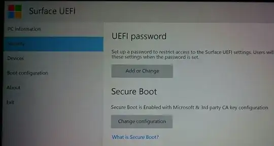

  3. Open Surface BIOS by pressing both Power and Volume_up
  4. Change boot order by drag and drop, USB Storage as first entry enter image description here
  5. Change secure boot settings to Secure boot is Enabled with Microsoft & 3rd party CA key configuration. (There is no need to completely disable secure boot) enter image description here

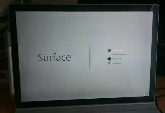

  6. Plugin the live USB stick and restart, Linux bootloader should come up automatically

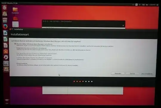

Install Ubuntu
  1. Simply click on the Installer shortcut and follow the instructions
  2. Choose "Ubuntu besides Windows Boot Manager". If you shrinked the Windows partition, partitioning can be done automatically. enter image description here
