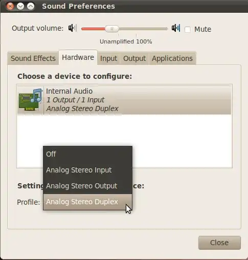

We may need another sound profile to be able to connect both, the microphone, and the audio for telephony usage.
To change the audio profile used with PulesAudio open "Sound Preferences.../Hardware, and try with the "Duplex" profile.
Audio profiles can also be changed with pavucontrol Install pavucontrol in case it is installed.

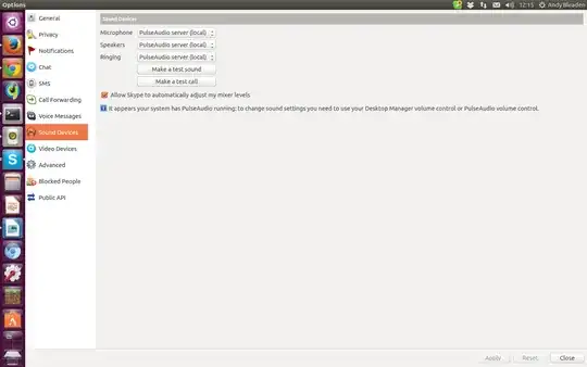

I always find that unticking the skype default voice setup works when I install skype on PCs.
Start Skype normally.
Navigate down to Options>Sound Devices.
Spot the button below and untick it
As you can see I also have pulse audio running and they can sometimes conflict.
Let us know how you get on.
