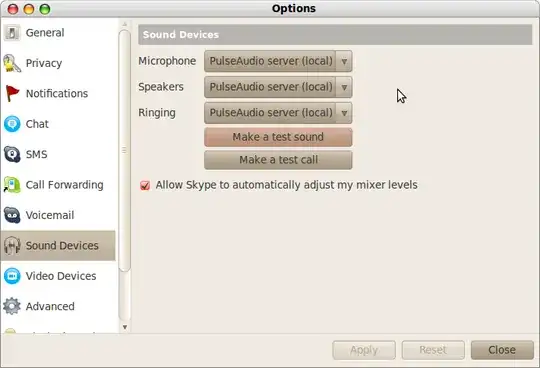

Skype doesn't find my audio input. If I click on the "Microphone" no other suggestions appears, my web camera works.
In windows everything works.
Skype sound options

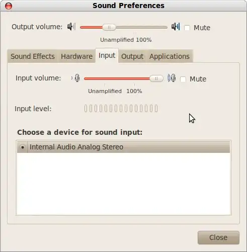

This is my audio preferences. enter image description here

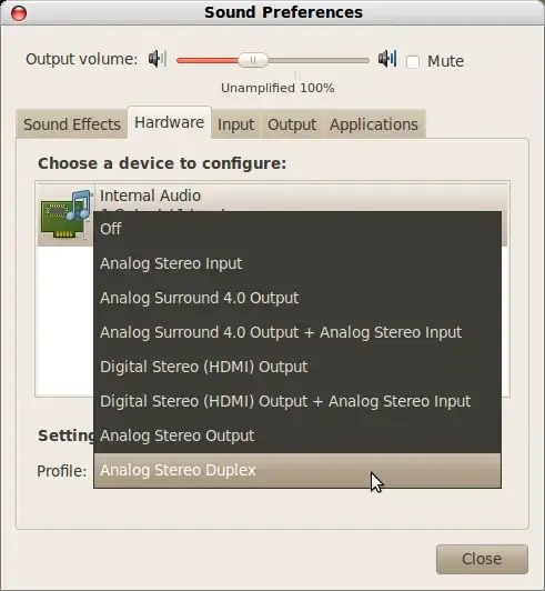

Under Sound Preferences, please post the "Hardware Tab" in order to check your profile, which should use at least an output + an input being in use. Otherwise, your hardware is not using the input profile which can be chosen right there.
This answer may be changed after your posting in order to give you further details. Here is a sample. Thank you.

-2
Make sure to use the latest Skype beta version for Linux from http://www.skype.com/intl/en/get-skype/on-your-computer/linux/. Older versions do not work properly with Pulse Audio. Also uncheck the "Allow skype to automatically adjust my mixer levels", it caused a lot of trouble for me. After that, reset all your mixer levels by opening a command-line and running alsactl init.
