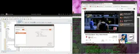

My mobile running Android which is using bluetooth connected to my Ubuntu 12.10 64-bit.
My goal is to have following step:
  • In my Ubuntu desktop I am running music from YouTube
  • Mobile phone is connected to Ubuntu Desktop using bluetooth
  • From my mobile I have a head phone connected to my ear
  • I want to hear the music from my mobile the same audio which is playing in desktop
How can I do that? in this popup dialog I don't have any kind of option to send audio output on bluetooth.
