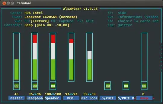

Alsamixer gives :
card :HDA Intel
chip: Conexant CX20561 (Hermosa)
What can I do?

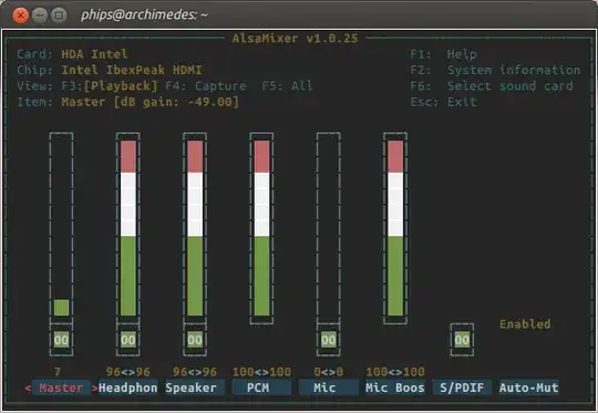

Open alsamixer, make sure your output channels are not muted. Press the left and right arrow keys, to move to different channels and press m to toggle mute / unmute. A "M/M" at the bottom of a column means it's muted
It should look kinda like this:
alsamixer screenshot
