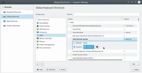

In Kubuntu 18.04, one can toggle borders (including the titlebar) and the maximized state of windows relatively simply.
In System Settings, choose Shortcuts > Global Shortcuts > KWin. In there, scroll to Hide Window Borders and set a shortcut. I chose Meta+D and clicked Apply.
Toggle borders Now I can toggle borders by just pressing Meta+D.

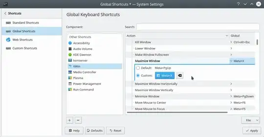

Still, while in System Settings > Shortcuts > Global Shortcuts > KWin (in Kubuntu 18.04.1 LTS, Kwin corresponds to System Settings Module), scroll further down to Maximize Window. Here, I chose Meta+X and clicked Apply.
Maximize Windows Now I can toggle between a non-maximized window and a maximized one by just pressing Meta+X.
Obviously, I can use both Meta+D and Meta+X on the same window whenever I want.

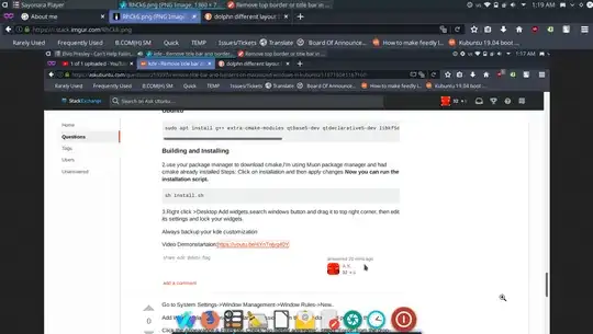

Remove top border or title bar in KDE/Kubuntu while retaining the windows button (Window Buttons Applet)
Requirements:
1.Latte Dock - Install from discover,right click on the dock, layouts>preferences>borderless> tick borderless>under layouts
  • Requires
  • Qt >= 5.9
  • KF5 >= 5.38
  • Plasma >= 5.12
  • KDecoration2 >= 5.12
  • Qt elements: Gui Qml Quick
  • KF5 elements: CoreAddons Declarative Plasma PlasmaQuick extra-cmake-modules Install
2.Window Buttons Applet - Download from (present under files tab) https://store.kde.org/p/1272871/
3.Follow this:
  1. Copy and paste this command in terminal
Before running the installation script you have to install the dependencies needed for compiling.
Ubuntu
sudo apt install g++ extra-cmake-modules qtbase5-dev qtdeclarative5-dev libkf5declarative-dev libkf5plasma-dev libkdecorations2-dev gettext
Building and Installing
2.use your package manager to download cmake,I'm using Muon package manager and had cmake already installed Steps: Click on installation and then apply changes Now you can run the installation script.
sh install.sh
3.Right click >Desktop Add widgets,search windows button and drag it to top right corner, then edit its settings and lock your widgets.
Always backup your kde customization
Video Demonstartaion:https://youtu.be/4YnTnjyq40Y
This how your desktop will look after that with minimize,maximize and close buttons on the top right without borders enter image description here
