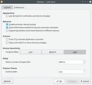

They correspond with unchecking "Support borderless maximized windows in different layouts" in the Preferences tab of the Latte Dock settings dialog.

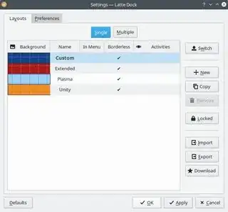

Alternatively, you can enable the setting and check the "Borderless" option (by double clicking) for the desired layouts in the Layout tab.
