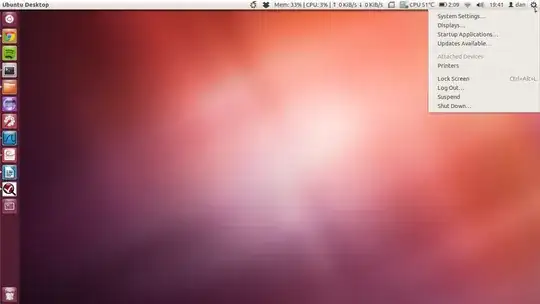

When the session is resumed from suspend (with the discrete DPU disabled), the fan will spin up uncontrollably, what I would like to do is edit the suspend script or assign a new script to the suspend option on the power menu. This is so I can re-enable the GPU before suspending. Power Menu
