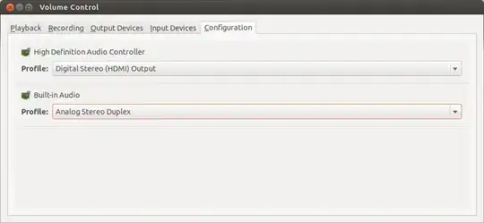

To define the recording source for any recording application we may install pavucontrol.
As soon as we record any audio stream the name of the recording application and the source from where it records will be shown in the Recording tab. We then may be able to change the source to Monitor of <your soundcard> to record the output of our soundcard:
We may have to choose another audio profile in addition. This can be done from the "Configuration"-tab of pavucontrol, e.g. a "Duplex" sound profile for output of the microphone to our local audio sink:

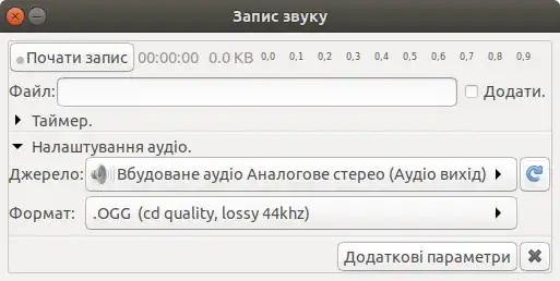

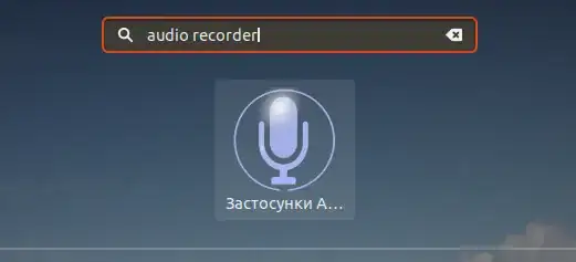

My favourite GUI audio recording tool is Audio Recorder which is able to capture audio from all of possible sources. I'm sure this software is must-have tool.
Install Audio Recorder:
sudo apt-add-repository ppa:audio-recorder/ppa
sudo apt update
sudo apt install audio-recorder
Run it (my system locale is Ukrainan): enter image description here
To record system sounds select "Built-in Audio Analog Stereo (output)" as Source.
It's possible to select many of audio sources including Skype or even define your own.

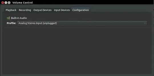

You may have to select Analog Stereo Input (unplugged) in PulseAudio Volume Control (pavucontrol), in order to make it work.
This was the only way I was able to record audio after trying everything else I could find on recording audio from the sound card. Unfortunately you can't listen to the output at the same time with this setting.
Also see screenshot:
