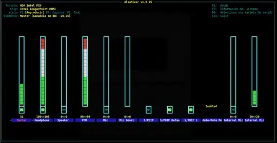

Edit: As requested, a capture of alsamixer: alsamixer
