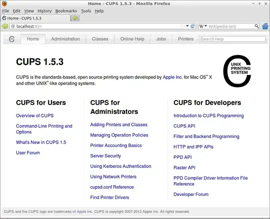

One common, production (i.e., not just diagnostic) use of localhost on Ubuntu is to perform advanced printer configuration. In a web browser, go to:
http://localhost:631
CUPS runs a web server on port 631, and this can be used to configure printing, regardless of what GUI you are running (or even if you are not running a GUI at all).
Screenshot showing CUPS in a web browser
If you try connecting to http://127.0.0.1:631, this will work too. However, if you try to connect to http://127.0.0.2, it will not. All the 127.*.*.* addresses identify your computer on the loopback interface, but a server program can decide to bind just to a specific IP address.
