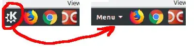

I want to customize my KDE desktop. Firstly I want to replace an annoying letter "K" in a Menu. For example:
I supposed that it changes by editing some *.css files. For instance gnome-shell has /usr/share/gnome-shell/theme/gnome-shell.css. But I do not see anything like that in /usr/share/kde4/apps/desktoptheme/default/.
Also I tried to copy /usr/share/kde4/apps/desktoptheme/ to ~/.kde/share/apps/desktoptheme/ and to replace icons/kpackagekit.svgz with my own icon, but it didn't work.
So, how to change it? How to change this little thing? Should I copy something to somewhere and edit any CSS file? Or...

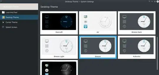

The icon of that widget depends on the desktop theme: System Settings - Workspace theme - Desktop theme.
The one with K is that of the Kubuntu desktop theme, changing to Breeze presents you with a different icon:
(I think I have a bug: sometimes I need to restart the desktop (killall plasmashell; plasmashell &) to see that change.)

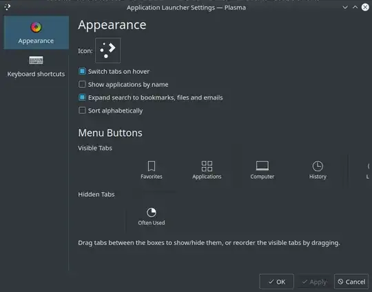

But you also can change the icon without changing the theme: Right click on the widget and select "Application Launcher Settings", then "Appearance", and click the icon button there.

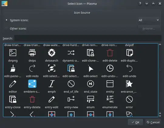

Then select "choose".
The choice is large, you can select by category or from "All" or (from "Other icons") any icon file you have.

  1. Right click on the "K" (as I can see in your screenshots, it's the icon for an Application Launcher, which is in the panel).
  2. In the contextual menu, click on "Application Launcher Settings".
  3. Click on the icon button and click on "choose".
  4. Select the icon of your preference and accept the changes.
