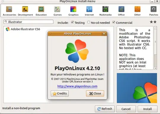

Then click ➕ Install a program in PlayOnLinux and search for the Windows program that you want to install.
