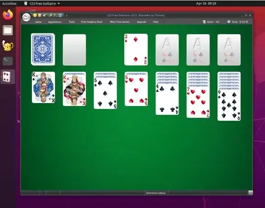

    This game runs well under Wine but not all games will, so a degree of research and experimentation is required before success is realised. However the basic technique illustrated here is what one will do to get Windows games running under Wine using Ubuntu, at times a more sophisticated approach will be required. However this particular game will run fine, as the screenshot below illustrates:
