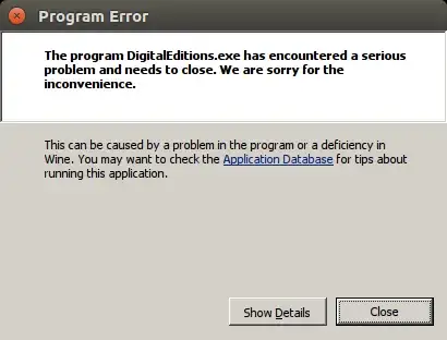

I'm trying to install ADE in Ubuntu 16.04 32 bit.
First I run: wine ~/Downloads/ADE_4.5_Installer.exe but got an error
Second, I tried to install with winetricks, go to install an application option and select Adobe Digital Editions 4.5 and at the end, it shows the error.
In both methods, it shows the same error:
Program Error Detail shows:
Unhandled exception: page fault on read access to 0x00000000 in 32-bit code (0x10001559).

I've tried PlayOnLinux, but same issue At the end, it shows same as previous,
Here Program error details shows, along with previous error message,
System information:
    Wine build: wine-1.7.46 (Staging)
    Platform: i386
    Host system: Linux
    Host version: 4.15.0-22-generic

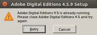

You need to install using ADE 4.5.0, rather than any later version of 4.5.
From https://web.archive.org/web/20160309131635/https://adedownload.adobe.com/pub/adobe/digitaleditions/ADE_4.5_Installer.exe :
This was an issue with the Adobe Digital Editions 4.5.6 installer from the Adobe website. I was able to avoid the problem by downgrading to the 4.5.0 installer
Additionally, from merpuis's comment here https://www.playonlinux.com/en/app-2671-Adobe_Digital_Editions_45.html:
I have been trying to get this running as well. Initially, after some fighting with it, I was able to get it to install using the script, but it gave me the error about already running. So I found the older version (4.5.0) and installed it instead.
In my case (Ubuntu 18.04) I then had a "serious error" after installing when running ADE, so it ultimately didn't work... but at least it did install.
Unfortunately, the filehippo link from the winehq page is dead and I've been unable to find a replacement download. I also don't have my copy anymore.
Note that neither of these are actually 4.5.0, so they'll give the already running error: https://filehippo.com/download_adobe_digital_editions/4.5.0.0.0/ and https://adedownload.adobe.com/pub/adobe/digitaleditions/ADE_4.5_Installer.exe.
