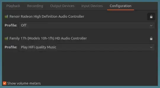

I have an external monitor connected to my laptop through DisplayPort, and faced this problem in Ubuntu 22.04. Here is how I resolved it
  1. Open pavucontrol and go to Configuration tab.
  2. Change the profile of the HDMI/DisplayPort card* to "Off".
  3. Press the lock icon on right side of card to lock the profile.
This profile will now persist through suspend and addition of HDMI/DisplayPort devices.
*To find which audio card sends output to HDMI/DisplayPort, use the command pacmd list-cards. The card will have 'HDMI' or 'DisplayPort' listed in its list of ports.
