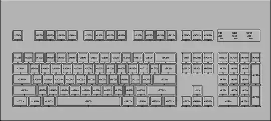

The key <xxxx> entries are the name of the keys and the {[]}; entries are the symbols
The image below will show you the key codes:
Now to create your custom keyboard layout you need to replace the contents of {[]}; with the symbol names you want.

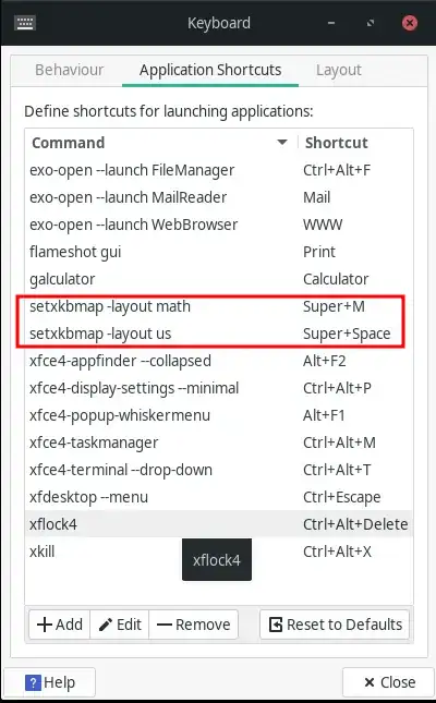

Before you enable your new layout make sure you have set up some shortcuts to switch between them, for example I am using xfce,so I have:
Now we can switch between the math and standard layout easily.
