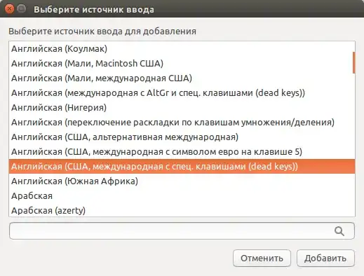

But it still works with double pressing. In Unity keyboard chooser I still can't find my layout:
Layouts chooser
If i choose English US-International it shows only standard Us-International without my edits.

I found solution!
After editing
/usr/share/X11/xkb/symblos/us
I needed to edit files
/usr/share/X11/xkb/rules/base.xml
/usr/share/X11/xkb/rules/evdev.xml
Add lines in both files under section
  <layoutList>
      <layout>
          <configItem>
              <name>us</name>
              <shortDescription>en</shortDescription>
              <description>English (US)</description>
              <languageList>
                  <iso639Id>eng</iso639Id>
              </languageList>
          </configItem>
          <variantList>
              <variant>
                  <configItem>
                      <name>uni-intl</name>
                      <description>English (US, UNIm-95 international with dead keys</description>
                  </configItem>
              </variant>
Here you can get my us, base.xml, evdev.xml
