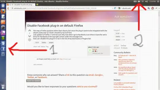

Just update to Firefox 17 and not sure why now when I go to Facebook a icon show in launcher and a entry for Facebook at the top-right conner under the message icon.
How can I disable this plug-in? It not in the list of my Extensions or Plugins list! Update Here is an screenshot: enter image description here

Oh, and while I was writing this answer you provided an image. Now, I'm not using Unity, which has a few "social" activities of its own but still what I've suggested may help!
This is unity webapps feature of Unity. Here is a related post on OMGUbuntu
This feature is totally unrelated to the firefox version you are using. You can stop the integration by disabling Unity webapps extension from Firefox addons.
Firefox 17 adds a social integration option. However, this does not integrate with Unity environment the way you have shown.
