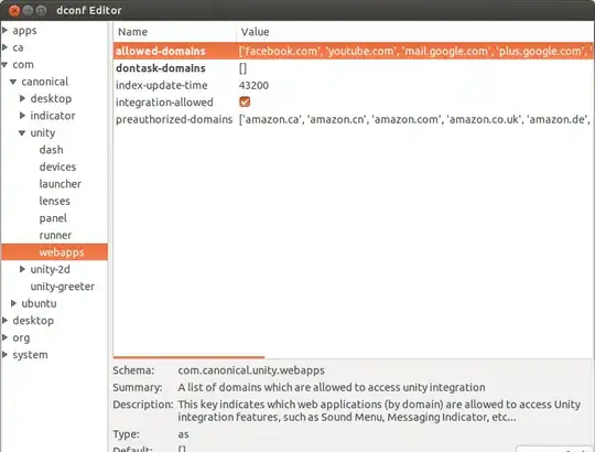

Press Alt + F2 , run dconf-editor.
Now go to com → canonical → unity → webapps.
Edit Allowed domain value and remove the undesired entry.

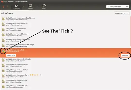

(A small addition to Web-E's excellent answer.)
Go to the Dash → Ubuntu Software Center → search 'unity-webapps'
You'll now see a list of all the web apps supported by the Unity desktop. Web apps you've installed will have a tick mark on them, and from there installing/removing web apps should be goddamn easy!
WARNING! Do NOT remove the unity-webapps-service package (titled "Service for Web Apps integration with the Unity desktop"). This program runs the Desktop service used for Web Apps integration with Unity desktop.

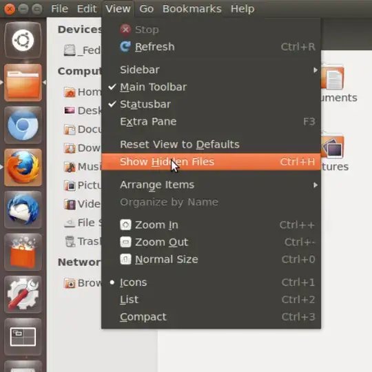

If you have already «removed» the webapp with dconf-editor or unsettings and it still shows on the dash, then you have to manually delete it.
  1. Open the file manager
  2. Click View > Show Hidden Files (alternatively CTRL + h)
  1. Open this folder: .local
  2. Open this folder: share
  3. Open this folder: applications
  4. Search the «desktop» file you want and delete it.
Done!!

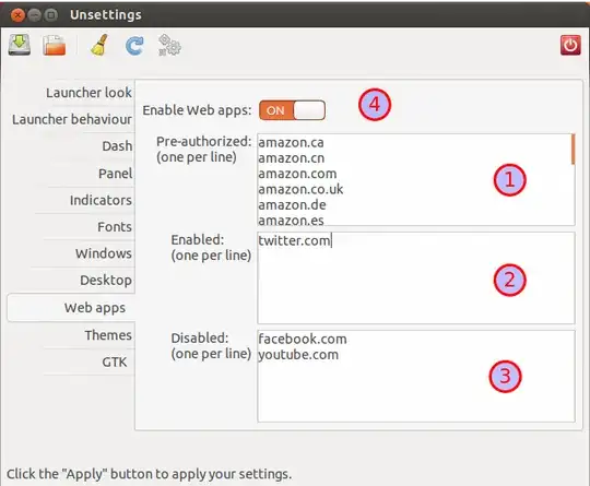

You can use Unsettings to enable and disable installed web apps:
In the "Web apps" tab remove the undesired domains from the "Pre-authorized" (1) or "Enabled" (2) fields (that are the allowed-domains and preauthorized-domains entries in dconf-editor) and at them to the "Disabled" (3) field, if you do not want to be asked for them any more (dontask-domains in dconf-editor).
Use the "Enable Web apps" switch (4) to switch off the whole web apps support.

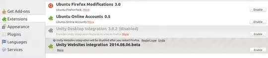

quickest solution : go to browers' extensions/addons setting and disable all mentioning ubuntu - so for firefox do : URL : about:addons chrome use tools -> extentions
