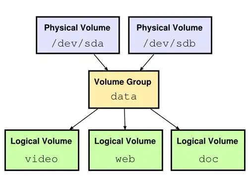

  1. Create a physical volume on the first hard drive, and another physical volume on the second hard drive.
  2. Create a new volume group, assigning both physical volumes to it.
  3. Create a new logical volume in that volume group.
  4. Create a new ext3 filesystem in that logical volume.
The diagram I copied from this answer visualises this (but with three filesystems, rather than just one):
LVM schema
As you can see, creating an ext3 filesystem is the last step, not the first. If you have an existing ext3 partition that isn't in LVM, you can't migrate it to LVM. You'll have to backup the partition, delete the partition, setup LVM, and then copy the files back.
