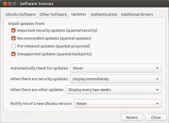

I configured this:
Automatically check for updates: Never
But the update manager keeps poping up against my wishes, I have no control. I feel like I'm using Windows again.
I want to be able to install updates from time to time, manually.
What can I do?

Just turning off notification of updates will not be enough. There are several background jobs that run apt-get update (including a nightly cron job if I remember right).
To stop the pop-up run update-manager
Then in settings, set Update automaticly to 'Never' and Notify of new version to 'Never'
Sample settings
I suggest leave security at immediately and, setting "others" to every two weeks.
