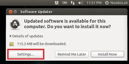

How to remove/suspend/blacklist/hide/disable completely from the Ubuntu 13.10 this following popup via command line? (even with GUI when i click settings and insert my password it still fails and keep repeating it)
  • this setup is running in a busy Railway, where passengers passing very busy place every day almost every hour i have this strange popup "Software update" even i do not want it
Please kindly anyone suggest how to remove this to stop disturbing? I have tried following but none works:

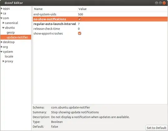

  • install dconf-editor by typing : sudo apt-get install dconf-editor `
  • Now open it using: sudo dconf-editor
  • go to com->ubuntu->update-notifer-> no-show-notifications and enable it
.enter image description here
You can do that same using command line by typing :dconf write /com/ubuntu/update-notifier/no-show-notifations true
