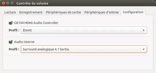

Then, pavucontrol may help you, as replied in this question. In the configuration tab, you should see different profiles for your sound card, for example "Suround analogiq 4.1" that means that you want to use 4 channels and 1 subwoofer.

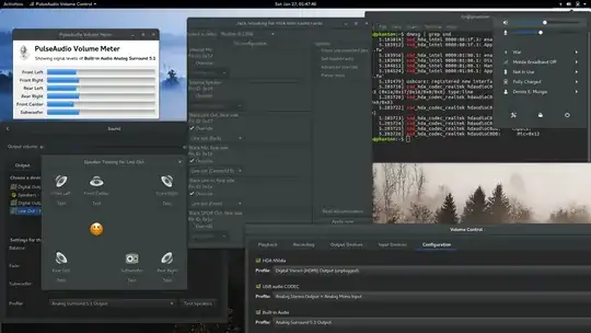

3.5mm audio jack connections to the sound card on the laptop/motherboard:
On the rear of the Logitech system, all the I/Os are color coded. In my case, I swapped the GREEN line with the YELLOW line such that the GREEN line feed would correspond to the Center/LFE feed, as it does on Windows under the Realtek HD Audio manager panel. Then, on the computer, I connected the feeds in the order, top to bottom: Black, Green then Yellow at the very end.
Final step after reboot to use the new setup:
Use pavucontrol (search for it in the app launcher or launch from terminal) and under the configuration tab, select the "Analog Surround 5.1 Output" profile. This is important, because apps won't use your speaker layout UNTIL this is selected.
When done, you can verify your setup (as shown below) with the sound settings applet on Ubuntu by running the audio tests. Confirm that audio is routed correctly to each speaker. If not, remap the pin layout again using hdajackretask and retest again.
Screen shots of success:
As attached:
Great success, showing audio output mapping from a minimized audio player
